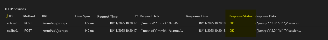

  • Under the General page, there is a pagebutton/subpage for 'HTTP Communication...'. Would it be possible to enable the Logging state at the top of this page? This stores the request and responses in the table for a clearer overview. It would be useful to know the first row which is NOT having a 'OK' value for the column 'Response Status'. This failing API request might be the reason for the Authentication error status.
Let us know if could verify the user permission, element log file or the failing API command from the HTTP Sessions table.
