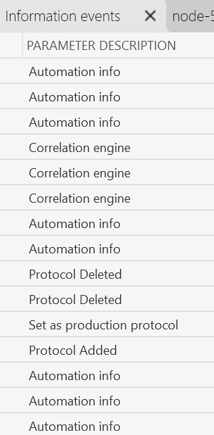

I would like to set up a correlation rule which would trigger my script each time a protocol is added or deleted from the DMS.
I tried some combinations with alarm filters and rule conditions but I couldn't get it to trigger on these information events ("Protocol Deleted" and "Protocol Added"):

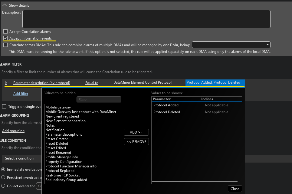

I would expect a rule like the below to trigger each time a protocol is added or deleted.
Benjamin Hodžić [SLC] [DevOps Advocate] Selected answer as best 23rd October 2025
Benjamin Hodžić [SLC] [DevOps Advocate] commented 23rd October 2025
Thank you, Jan-Klaas! It works.
