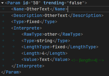

Hi Sam,
You should be on the right path, the "others" tag is indeed what you need.
I'm not entirely sure about the exact cause of your issues, but the following things caught my eye. Please try to make these changes and let me know if that would resolve your problems:
  1. Your "Other" NAN parameter (3312) currently has the length type "next param". You can make this "Fixed": See the following example (your length should be 3 instead of 4 in my case):
  2. Your Exception for parameter 3313 is still present. You can/should remove that one as the types of the "values" of that exception don't have the right type (the string NaN vs the number -1)
I hope this helps!

Thank you!!
This worked.
