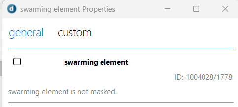

And finally the last note: DataMinerID here has to be the left part that you find in the properties window:
